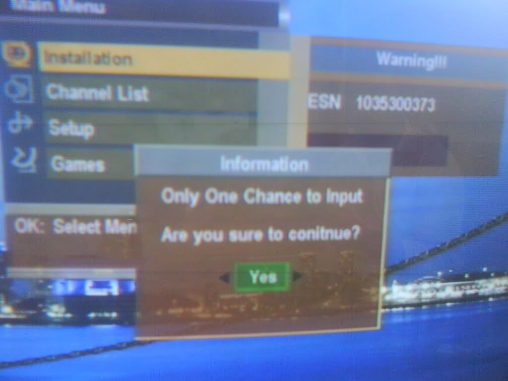

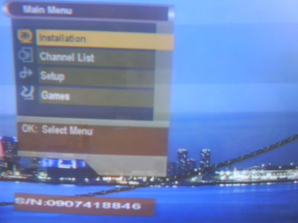

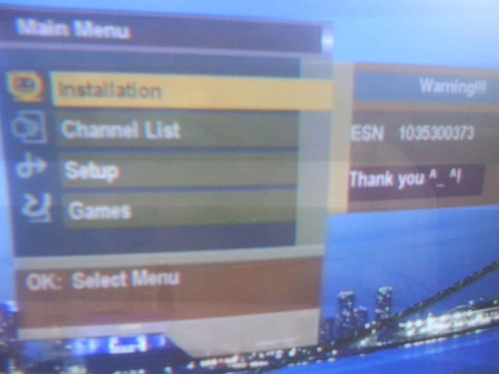

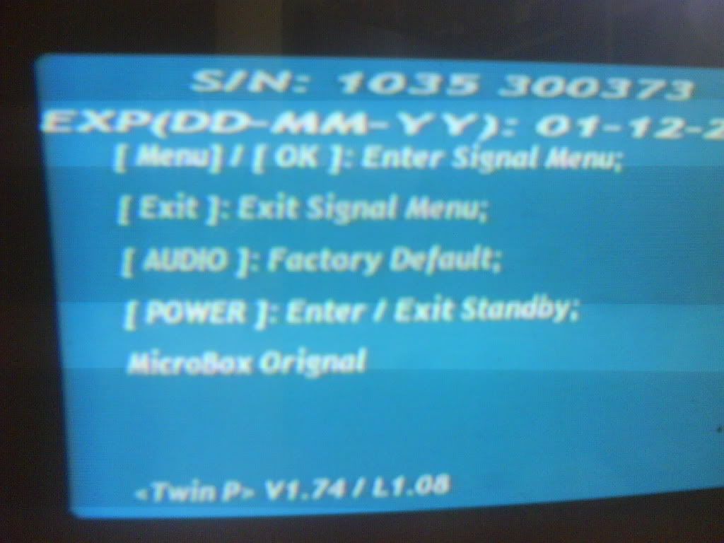

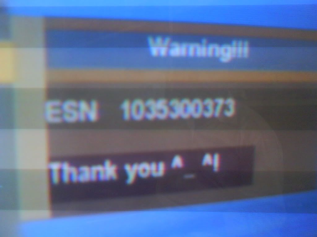

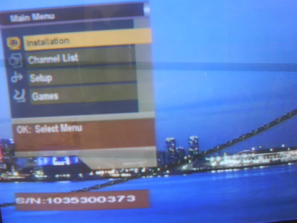

after installation of this Soft-Ware you will have to insert the AV cable in your microbox now here you will see the serial number of microbox that is 0000000 now in the main menu you will press F3 button from remote of Microbox here you will see the small window which is appeared in the right corner beside the main menu in which serial number is written 0000000 now you will enter the desired serial which is 1035800373 or 1066800373 or any other serial which you want to enter. after entering the serial number you will press OK button from remote that will show the message DO YOU REALLY WANT TO CHANGE SERIAL you will turn that message to YES and press OK button again now your serial number of microbox is changed and install the 1.74M.E version Soft-Ware in your microbox and enjoy.
Note:serial number is changed only for one time. not again and again.
